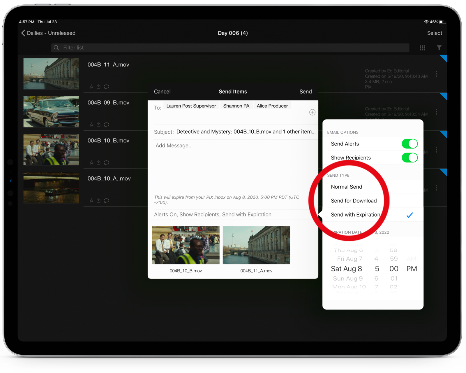

To share with an expiration:
- Select the Playlist you wish to share.
- Click the 3 dots on the right side of your screen and select Send.
- The send window will appear.
- Enter the recipients, subject, and message in the Send Items window.
- Below the “Add Message…” section, select Send with Expiration.
- Select a date and time you would like the content to expire.
- When entering the date and time, please note that your selection will respect the timezone you are in.
Send a notification with expiry time and date:
Leave the Send Alerts toggled on to send the recipients an email notification. Toggle to off to prevent an email from being sent.
The notification will contain a link that takes the recipient directly to the item after logging in. The email will also list the date and time the content is due to expire.
