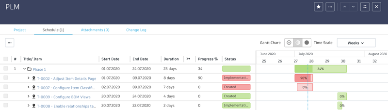

Implementation Phases The deliveries of a project can be split in various phases. A project has to be created before phases can be created as this is a mandatory input.
Once projects and phases have been created, tasks can be assigned to such phases to derive a real time schedule:
Schedule
In order to assign an Implementation Task to a Project Phase, users can use the Project & Phase fields of a task. These fields are connected so that when a user selects a phase, the system will select the matching project automatically. On the other hand, users can also select a project first to get the list of phases filtered.
