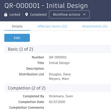

Once this process completed, completion details will be captured in the process’ details page, including the approver’s name, the approval date and also the comments that may have been entered during approval:
Details tab

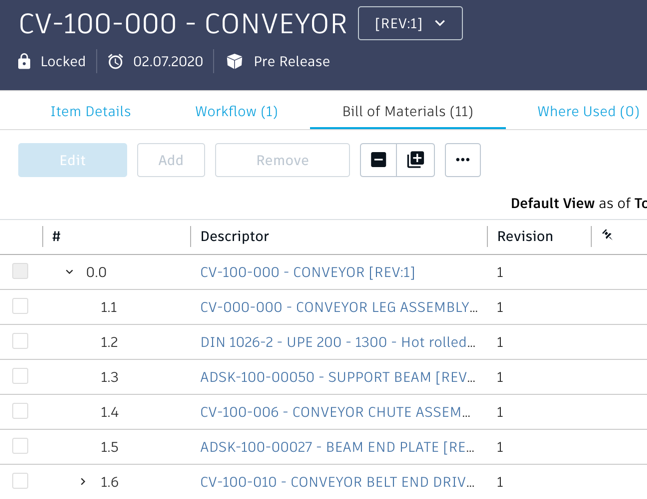

All items now will be available in a new version and locked. Users having the given permission, still can access the working version of the design to continue performing changes:
Bill of Materials tab
