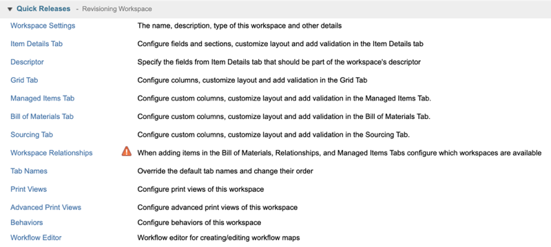

Open the Workspace Manager and locate the workspace Quick Releases. You will see that the configuration of workspace relationships is still pending.
Quick Releases - Revisioning Workspace

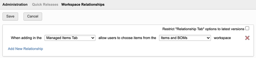

Open the Workspace Relationships utility and select your Items and BOMs workspace as valid option for the Managed Items Tab. Click Save:
