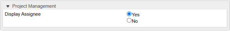

To be able to show the task assignee in the engineering project Gantt chart tab, you must enable this option in the Administration settings.
  1. Open Administration > System Configuration > General Settings.
  2. In the Project Management section next to Display Assignee, select Yes.
    display assignee
  3. Click Save.
