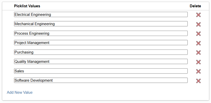

Included in this template is a value picklist that define specific teams. The teams are as follows.
project teams
Within an engineering project, specific team members are chosen to belong to one or more teams listed in this picklist. Autodesk recommends that the groups you create in your tenant align with this picklist. Alternatively, you can modify this picklist to align with your organization’s teams.
