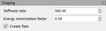

  • Stiffness Ratio: The ratio of stiffness along a cell's longitudinal direction compared to its diagonal direction. Allowable range is 50-10,000. A good value to start with is 500.
  • Energy Minimization Factor: A correction factor to move the nodes to positions where the distortion energy of the draped composite is at a minimum. Allowable range is 0 to 1. A good value to start with is 0.50.
  • Create Flats: Creates a set of flattened shapes of your ply. One or more flattened contours will be created and superimposed on the surface. You can later manually edit the flats, but if you regenerate this strategy with modified draping settings, a new flattened shape will be created, overwriting any manual edits you might have made.

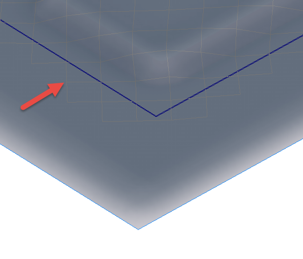

  • Draping Mesh: Similar to other mesh types, this is a mathematical division of the ply surface into a grid based on weft values. Smaller weft values will result in better quality flats, but may increase file size and impact performance. The draping mesh is also affected by the Stiffness Ratio and Energy Minimization Factor values. Enough mesh is created so that it extends beyond the boundaries of the ply.

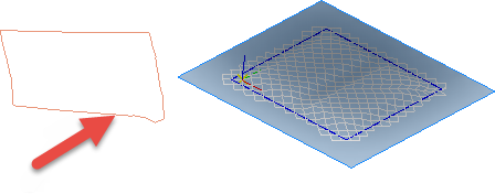

  • Flat Contours: These are the flattened shapes of material that will be used for draping. They are only created if you select Create Flats in the Strategy dialog box. They are superimposed on, or placed close to, the surface in the application window, or on a flattening plane if your layup includes one. A node for each contour is created in the TruPlan browser under the Flat Patterns node in your strategy. For every boundary that a ply has, a flat contour is created for it. You can edit contours, and you can also change the boundaries upon which they are based in the Ply dialog box.
