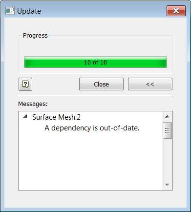

During updates, a dialog box provides progress information and error messages, if applicable. You can also see these error messages by mousing over items in the TruPlan browser.
