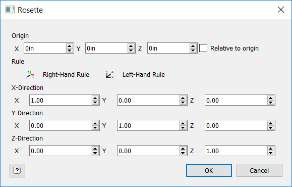

Rosette Dialog Box Controls
Origin
Enter the origin point for the rosette; that is, the start point of the three axes.
Rule
Select the orientation convention you want to use for the rosette (right- or left-hand rule). This determines the rotation direction of your axes.
X, Y, and Z Direction Boxes
Enter values to define the three axes of the rosette.
