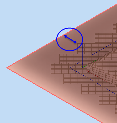

  • The workpiece surface needs to be larger than the ply boundaries of the largest ply in order to calculate tool paths correctly. The surface must extend by at least one bandwidth past the ply boundary. For example, if you have a fiber placement machine that uses a 150mm band, then you will need to extend the reference surface at least 150mm past every edge of the largest ply.
