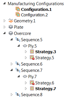

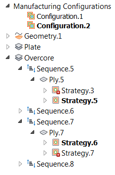

In TruPlan, a manufacturing configuration is set of strategies and geometry that will be used in other applications. Because every ply or sub-ply in an assembly can have multiple strategies associated with it, you use configurations to indicate which strategy to use for each ply or sub-ply.
In these examples in the TruPlan browser:
  • Configuration.1 includes Strategy.3 and Strategy.7.
  • Configuration.2 includes Strategy.5 and Strategy.6.
The bolded configuration is the default, or "active." When you open your file in TruFiber, this is the one you see, but you can switch to the other configurations.
Bolded strategies are the ones included in the active configuration.

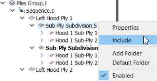

Include Sub-Plies in a Configuration
If you have sub-plies in your project, they are organized into one or more subdivisions beneath a ply in the TruPlan browser. If a ply contains more than one subdivision, make sure to include the one you want as part of the active configuration.
  1. Right-click the subdivision you want to include in the configuration.
  2. Select Include from the context menu.
    The active subdivision is bolded.
  3. Navigate to each ply and repeat the previous two steps for other subdivisions you want to include.
