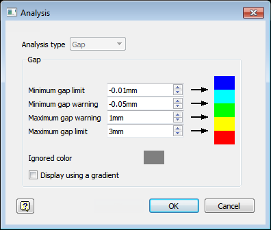

    The Analysis dialog box opens.
  3. Select a type from the Analysis Type box.
  4. Click OK.

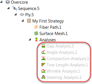

    The analysis is created under the strategy (or strategies) you selected.

    The analyses are added beneath the strategy (or strategies) in the TruPlan browser, using the most recent settings.

Modify or View the Settings of an Analysis
  1. Navigate to the strategy under which the analysis is located.
  2. Double-click the analysis to open the Analysis dialog box.
