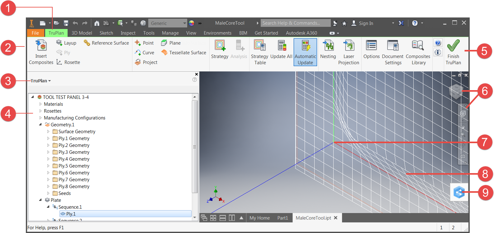

TruPlan Interface Overview
The TruPlan interface consists of a ribbon tab within a host application such as Autodesk Inventor.
- TruPlan tab within Autodesk Inventor.
- TruPlan ribbon. Read through the help for information on opening and inserting composites, creating objects such as layups and plies, adding and projecting points and curves, tessellating surfaces, and creating nesting and laser projection output.
- Browser view box. Select TruPlan to see the TruPlan browser view of your assembly.
TruPlan browser. A hierarchical view of the elements in a TruPlan assembly, including geometry, layups, plies, and so on.
Tip: See About the TruPlan Browser. -
Finish TruPlan button. Exits the TruPlan environment and returns you to the Inventor environment.
- Autodesk navigation tools: ViewCube, SteeringWheel, and so on. See the Inventor help.
- Rosette axis system for your assembly.
- Mesh of your object surface.
- Connect to Autodesk A360.
