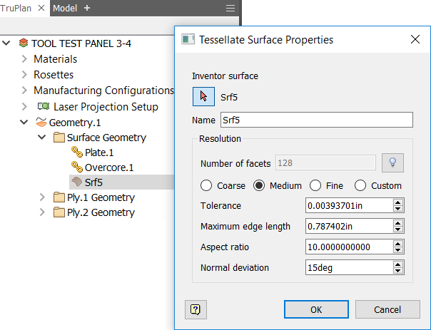

  1. Double-click an Inventor surface node in the TruPlan browser.
    The Tessellate Surface Properties dialog box opens.
  2. Optional: Enter a name for the surface in the Name box.
    This is the name you will see for the surface in the TruPlan browser.

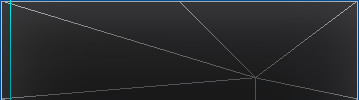

  3. Zoom into the surface to see its tessellation polygons.

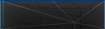

  4. Click Preview and adjust tessellation settings as needed.
    Tip: See Tessellation Dialog Box Reference for descriptions of the Tessellation controls.
    With Preview enabled, black lines representing the new settings are show on the surface alongside the current settings (white lines).
  5. Click OK to save the new settings.
