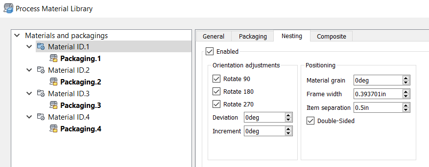

Set Nesting Parameters
Set default nesting values for materials. These will be used, and can be changed, later when creating a nest with Autodesk Nesting Utility.
  1. In the Process Material Library, select a material in the tree and click the Nesting tab.
  2. Select Enabled so that this material will be included in the nest.
  3. Make changes as needed to orientation adjustments.
    Each material can have a defined set of allowable nesting orientations. From this set of orientations, an optimal orientation is selected for each part as it is nested on the material. (You can also specify allowable orientations when setting up your nest later.)
    • Rotation angles: Presets in 90 degree intervals.
    • Deviation: Allowable deviation from the presets; for example, if you enter 10, a 90-degree orientation is allowed to deviate between 80 and 100.
    • Increment: Allowable deviation increments. For example, if you enter 2, a 10-degree deviation can occur in increments of 2; that is, 2, 4, 6, 8, and 10.
  4. Adjust Positioning values.
    These are the default positioning settings for nesting. They can be changed when creating a nest.
    • Material grain: A base angle from the X-axis that gives the material a grain appearance. To guarantee the same grain on nested shapes, set their orientation and deviation angles to 0, and deselect their Flip, Mirror, and Rotation boxes.
    • Frame width: How close shapes are allowed to be placed near the outer perimeter of the nesting area when using this material. This restriction can be refined on each side by adjusting Trim values in packaging.
    • Item separation: The allowable distance between items in a nest.
    • Double-sided: Select this if the material surface is the same on both its top and bottom. This can be important when considering flip and mirror.

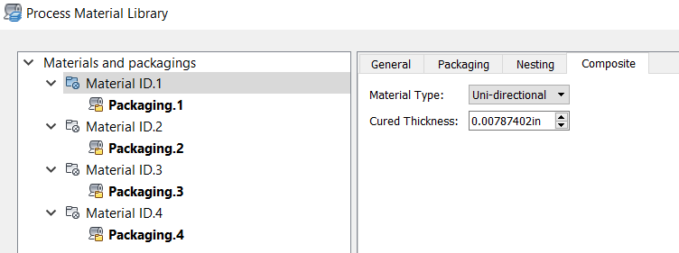

Set Composite Properties
  1. In the Process Material Library, select a material in the tree and click the Composite tab.
  2. Select a Material Type and enter a Cured Thickness.
