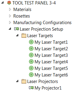

The target is created in a Laser Targets folder under the Laser Projection Setup node in the TruPlan browser.
Repeat this procedure for any additional targets you want to create. Remember that you should have six or more targets for a properly aligned projection system.

The projector is created in a Laser Projectors folder under the Laser Projection Setup node in the TruPlan browser.

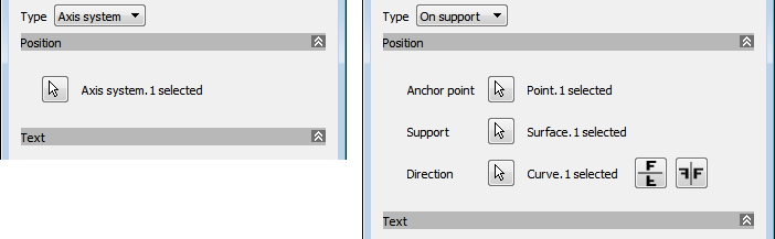

From the Type box, select how the text will be placed.
- Axis System: Text is placed at the origin of a rosette in the direction of the X-axis, with the text height in the Y direction. Z-direction determines whether the text is facing in or out.
- On Support: Text is placed at an anchor point, using a surface as support, along a defined direction.
The option you select determines the controls that are shown under Position in the dialog box.
If you selected Axis System in the previous step, click the selection arrow
under Position and select an axis system in the TruPlan browser.If you selected On Support in the previous step, use the selection arrows
under Position to add the following elements from the TruPlan browser:- Anchor Point: A point that defines the origin of the text.
- Support: A plane or surface that defines the orientation of the text.
- Direction: A line or curve that defines the direction and angle of the text; use the flip and mirror buttons
to change the direction or orientation of the text if needed.
