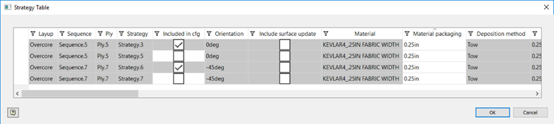

Open the Strategy Table Dialog Box
  • On the TruPlan ribbon, click Strategy Table .
    Each row in the table represents a strategy and its properties.
Edit the List of Strategies and Properties
  1. To add columns to the list, right-click a column header and select Display Columns, then select which columns you want to show.
  2. To sort by property, click the appropriate column header.
  3. To move a column to the left or right, click and drag it to its new location.
  4. To filter the list of strategies, right-click a column header and set the filter values you want.
    For example, to only show strategies whose warp is 0.25 inches, right-click the Warp header, select "Is equal to" and enter 0.25in in the Filter By dialog box.
  5. To edit individual values in the Strategy Table, make changes to them directly in the list of strategies. (Gray cells cannot be edited.)
  6. To duplicate, delete, or change the visibility of a strategy, right-click its row in the table and click Duplicate, Delete, or Visibility.
    When you duplicate a strategy, a copy is created under the same ply as the original strategy in the TruPlan browser, and its name is appended with "(Copy)".

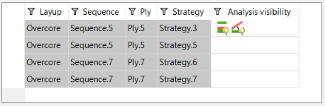

    • Analysis Visibility: Contains a few fundamental columns along with the Analysis Visibility column, which you can use to show or hide analyses for each strategy.
      Analysis Visibility View

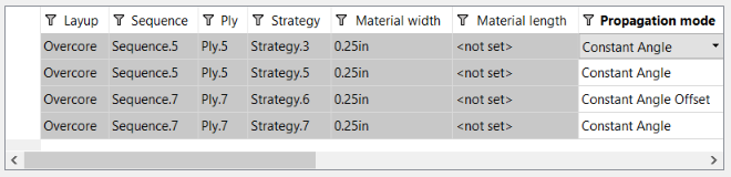

    • Fabric, Fiber Placement, or Tape Laying: These views show columns relevant to their respective manufacturing method; for example, the Fabric view includes the Material Length column, Fiber Placement includes Tow Overlap, and Tape Laying includes Cut Strategy.
      Fabric View

View and Change Analysis Visibility
  1. Find the Analysis Visibility column in the Strategy Table.
    By default, this column is on the far right. It contains icons representing analyses that have been created for each strategy.
  2. Click the coloured icons to enable or disable visibility.
Each type of analysis is indicated by its own icon:
  • : Gap
  • : Angle
  • : Compaction
  • : Tow Length
  • : Wrinkling
  • : Steering
  • : Tape Cut
The state of an icon indicates analysis status:
  • : A lit lightbulb means the analysis is visible.
  • : An unlit lightbulb means the analysis is hidden.
