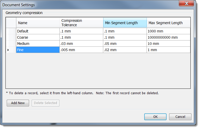

View and Add New Document Settings
These settings determine geometry compression tolerances and lengths between data points for the current document.
Compression Tolerance Sets how far approximated straight lines are able to sag away from the original curved geometry.
Min Segment Length If two laser data points are closer than this tolerance, then one point is removed until the distance between points grows larger than this value.
Max Segment Length If the distance between two laser data points exceeds this value, a point is added in the center between the two points. Points are added until the distance between points is smaller than this value.
