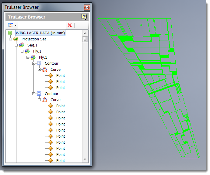

How you organize your data can impact efficiency and laser projection results. For example, a curve might require you to add points to achieve a smooth line. However, if you add too many points you might experience flicker. Breaking down projects into smaller groups can help minimize flicker, but you don't want to break them down into such small groups that you lose efficiency. Your shop floor workflows can also influence how you organize data. When drilling bolt holes do you drill all the holes in a zone before moving to the next zone? Or, do you drill all the holes for a specific bolt before moving on to drill for the next bolt type?
Simulation, canvas highlighting, and other view controls help you easily identify components and manage your data to achieve the best results.
The TruLaser browser provides an easy way to see how your project is structured.
Clicking an item in the tree highlights the item in the canvas for easy identification.
