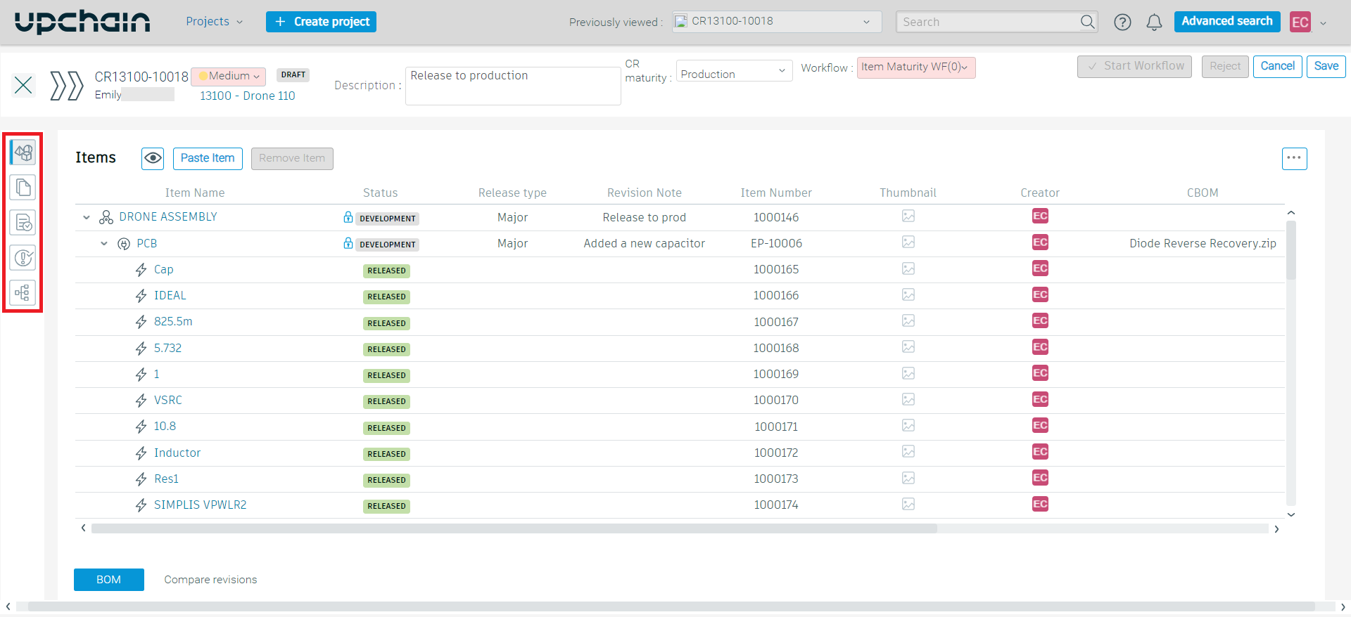

Explore the change request interface
The change request (CR) interface is divided into three main areas:
  • CR header
  • CR tabs
  • CR center view

CR tabs
Each CR tab contains different information relevant to the CR. Click each one to display its contents in the center view.
Note: This image shows Upchain's new theme. Click the chevron next to your profile icon in the main dashboard to open the user menu and select Switch theme.
Items tab
The items tab (itemtab) displays the items chosen for this CR and where you configure additional information about the items that affect how they are released, including the release type and revision note.
Click an item to view its details on the right side of the window.
If required, you may edit the table to display additional columns.
