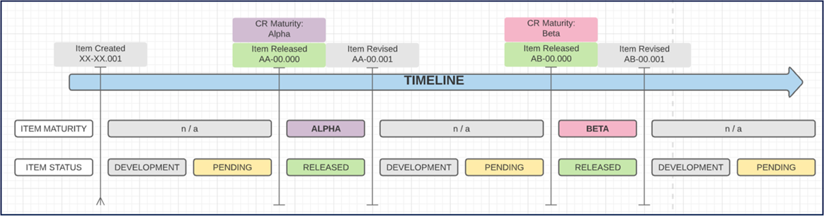

The following figure is an example of the lifecycle of an item that includes the evolution of its maturity level. You can see that the item has its maturity level configured to update to 'Alpha' after successfully progressing the item’s status from DEVELOPMENT to PENDING to RELEASED. In the next phase of the item's lifecycle, the item is given a new maturity level - ‘Beta’. This one too must successfully move from DEVELOPMENT to PENDING to RELEASED. Note that the previous maturity level is lost when the item is revised and a version number (001) is created.
The Tenant Administrator may configure the Update system primitive (UpdatePrimitive.png) in a CR workflow to set the item’s maturity level at the time of its release. The item’s maturity level is set when the CR process is successfully completed or remains at the level assigned before the CR process was initialized if the CR process is rejected. So in the example shared above, if the CR workflow (to move the item from 'Alpha' to 'Beta') is rejected, then the item maturity level remains at 'Alpha'.
