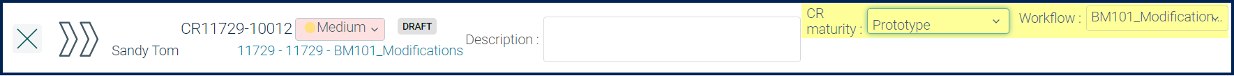

In the selected CR page, select a workflow from the Workflow drop-down list.
- If the CR workflow is configured to update the item's maturity status then the CR maturity field becomes active.
- If the workflow automatically updates the item maturity to a pre-determined value, you don't need to do anything.
- If the workflow does not have a pre-determined item maturity value, select a value from the CR maturity drop-down list.
