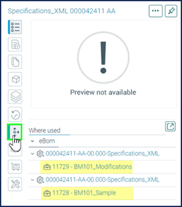

Tip: View the Where used tab in the item details pane in the Web application BOM table and the Upchain CAD Plugin to see a list of all eBOMs and projects to which the released item belongs before revising an item to ensure you understand the impact you might make.
