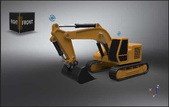

Show Camera Visualizations - Displays a representation of the cameras in the Render View.
Show Light Visualizations - Displays a representation of the lights in the Render View.
Show Joint Visualizations - Displays a representation of the joints in the Render View.
Show Volume Visualizations - Displays a representation of the volumes in the Render View.
