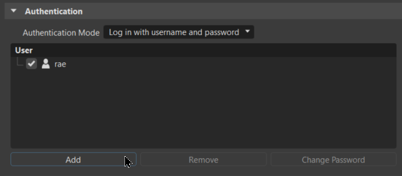

Authentication
Adds an extra layer of security, but requiring a user to log in and enter a password.
- Authenication Mode - If you don't want any authenication for the Web Server, select No Authentication. To set a user and password and add another layer of security, select Log in with username and password. Use the buttons below this field to add or remove users, as well as change passwords.

In the Authentication section, change Authentication Mode to Log in with username and password.
Click the Add button, then add a username and password.
Click Apply and Save. The new user will appear in the User section.
