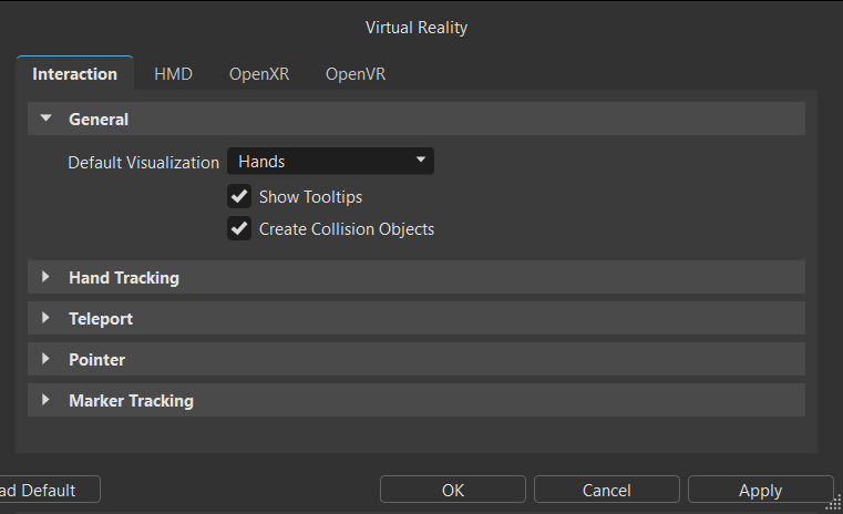

Interaction Tab
Use these parameters to set the default general, hand tracking, teleporting, and marker tracking interactions in VR.
General
- Default Visualization - Sets whether the initial session starts with VR hands or controllers displayed.
- Show Tooltips - Sets the default visibility behavior for controller tooltips. By default, this option is toggled on, displaying tooltips for the controller.
- Create Collision Objects - Sets the default state for the creation of collision objects for all touch sensors and WebEngines in the scene. When disabled, you cannot interact with touch sensors and WebEngines when using VR Hands.
