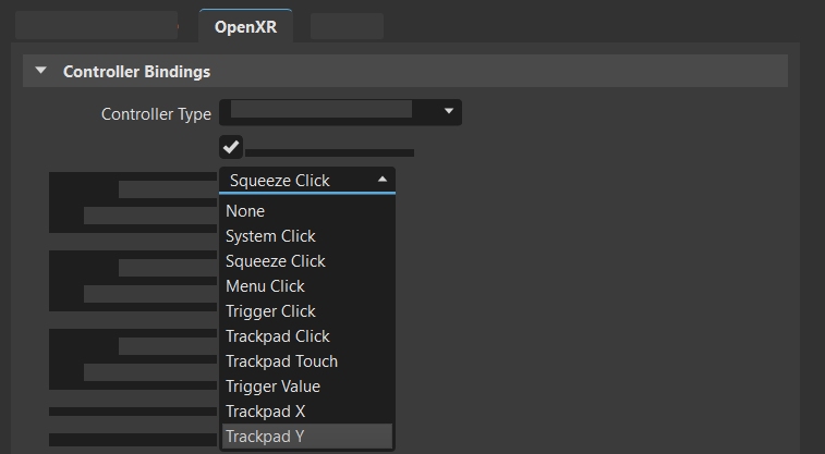

In the Menu Bar, click Edit > Preferences, then on the left side of the dialog box, select Extended Reality > OpenXR. After making any changes, press Apply and Save to save them.
Controller Type - Set the type of controller used. Choose from: HTC Vive, HTC Vive Cosmos, HTC Vive Focus 3, Oculus Touch, Microsoft MR Motion, and HP MR.
Left = Right - Set controller mapping as the same for both left and right controllers, when enabled. When disabled, the left and right controllers can have different bindings for a controller method and action.
Now, for each action, select its controller binding from the dropdown menu next to the action. When finished, press Apply.

Configuring a Controller
To customize the configuration of your controller buttons, do the following:
In Edit > Preferences > Extended Reality > OpenXR, select your controller from the Controller Type drop-down menu.
If you want each controller to have different bindings, enable the Left = Right checkbox; otherwise, ensure it is disabled.
Open the drop-down menu next to each action and select an option.
Tip:Actions can be disabled, so they are not accessing. For instructions, see Disabling an Action. Controller buttons can also be disabled. For instructions, see Disabling a Controller Button.
When finished, press Apply and Save.

Disabling an Action
To disable an action, so it is not accessible in a session, do the following:
- In Edit > Preferences > Extended Reality > OpenXR, select the desired action from the list.
- Open the drop-down menu next to the action and select None. Now, the action cannot be triggered during a session.
- When finished, press Apply and Save.
In the future, to make the action accessible, select a target from its drop-down, such as Menu Click or X Touch. Then, when finished, press Apply and Save.
