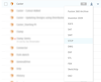

Download design files from the Fusion web client
  1. In the Fusion web client, navigate to the folder you want to download and hover over it.
  2. Select a file format for the design file you want to download.
    download fusion design
  3. Click OK to confirm exporting.

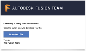

  4. You are sent an e-mail with a link to download the file. Open the e-mail and click the Download file button to download the file to your computer.
