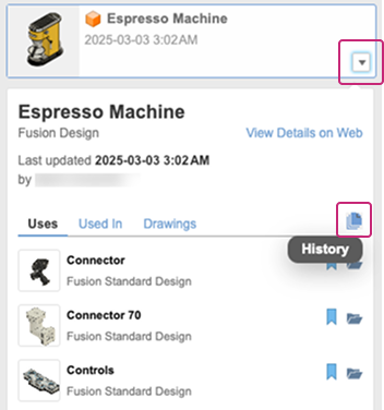

Data Panel
  1. In the Data Panel, locate the design you want to view.
  2. Click the arrow expand arrow next to the design to expand more details.
  3. Click the History button history.

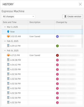

    The History dialog opens, displaying model saves, versions, revisions, property edits, and more.
    history button in data panel history panel

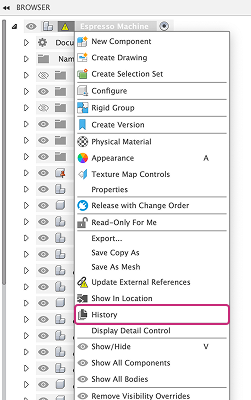

Browser
  1. In the Browser, right-click the top-level, internal, or external component whose history you'd like to view.
  2. Select History from the list.
    browser history button
View external components in a design
  1. In the Data Panel, navigate to the design you want to view.
  3. Click the Uses tab.
    All external components used by this design display in a list under the Uses tab.
View designs that include the design as a component
  3. Click the Usesd In tab.
    All design documents that use this design as an external component display in a list under the Used In tab.
View drawings that reference a design
  3. Click the Drawings tab.
    All drawings that reference this design display in a list under the Drawings tab.

  • In the History dialog, you can open a historical change of the design. Hover over a change to reveal the More menu more icon. Click it to expand the menu and select Open to view those changes in a separate document tab.
  • In the Data Panel, you can open a design listed under the Uses, Used In, or Drawings tabs. Click Open open folder to open the design in a separate document tab.
