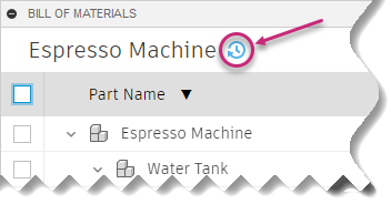

  4. Optional: In the Bill of Materials dialog, click the Part Name column header to sort alphabetically.
  5. Optional: Should data in the Bill of Materials seem to be out of date (for example due to updates done to a referenced component), click Refresh refresh button.
    refresh
Each time you save your design, the Bill of Materials is updated with the latest changes. You can work on your design with the Bill of Materials dialog open.

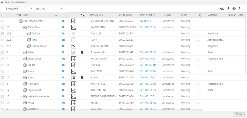

      The Bill of Materials opens.
      bom
  4. Optional: Should data in the Bill of Materials seem to be out of date (for example due to updates done to a referenced component), click More more > Refresh BOM refresh button.
    refresh
