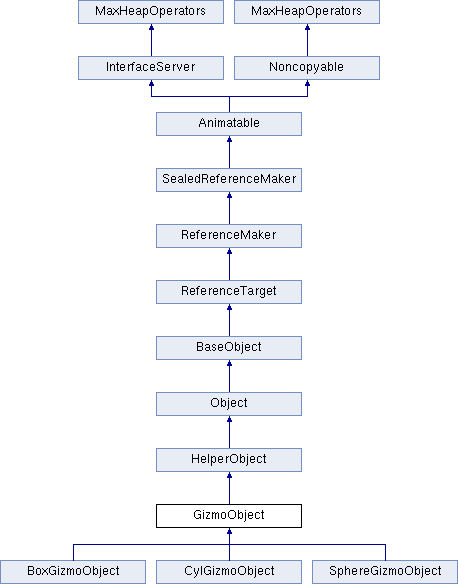

#include <gizmo.h>
Inheritance diagram for GizmoObject:Public Member Functions | |
