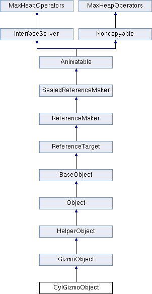

+ Inheritance diagram for CylGizmoObject:
