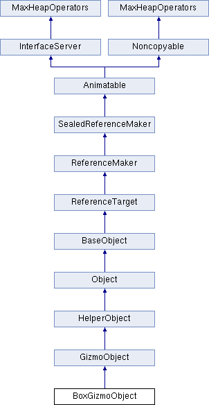

+ Inheritance diagram for BoxGizmoObject:
