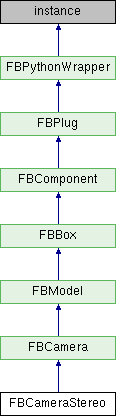

Inheritance diagram for FBCameraStereo:Public Member Functions | |
