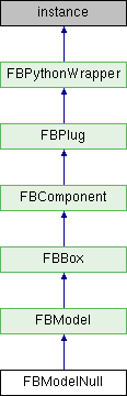

Null object class.
Inheritance diagram for FBModelNull:Public Member Functions | |
