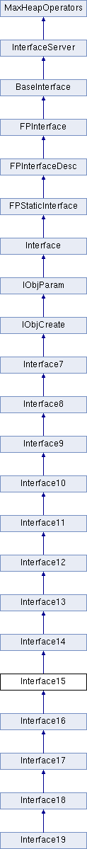

 Inheritance diagram for Interface15:
 Inheritance diagram for Interface15:| Public Member Functions | |
