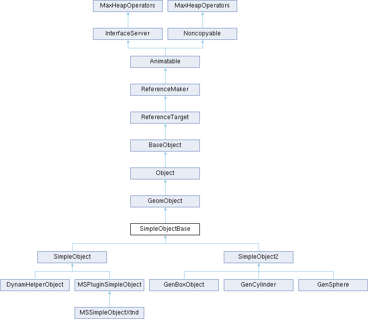

Inheritance diagram for SimpleObjectBase:

virtual CoreExport void BaseClone (ReferenceTarget *from, ReferenceTarget *to, RemapDir &remap)
 This method copies base class data from an object to its clone.
CoreExport RefResult NotifyDependents (const Interval &changeInt, PartID partID, RefMessage message, SClass_ID sclass=NOTIFY_ALL, BOOL propagate=TRUE, RefTargetHandle hTarg=nullptr, NotifyDependentsOption notifyDependentsOption=REFNOTIFY_ALLOW_OPTIMIZATIONS) override
 Notify all dependent RefMakers concerned with the message.
void FlagDependents (TimeValue t, PartID which=PART_PUT_IN_FG)
 This sends the REFMSG_FLAGDEPENDENTS message up the pipeline.
virtual void NotifyForeground (TimeValue t)
 This method is called to flag dependents into the FG.
virtual void NotifyTarget (int message, ReferenceMaker *hMaker)
 Sends messages to ReferenceTargets.
CoreExport ReferenceTarget ()
 Constructor.
virtual CoreExport RefResult AutoDelete ()
 Deletes the object when it has no more real dependents.
CoreExport RefResult MaybeAutoDelete ()
Public Member Functions inherited from ReferenceMaker
CoreExport RefResult ReplaceReference (int which, RefTargetHandle newtarg, BOOL delOld=TRUE)
 Used when cloning reference makers.
CoreExport RefResult DeleteAllRefsFromMe ()
 Deletes all references from this ReferenceMaker.
CoreExport RefResult DeleteAllRefs ()
 Deletes all references both to and from this item.
CoreExport RefResult DeleteReference (int i)
 Deletes the specified reference.
virtual BOOL CanTransferReference (int i)
 Tells whether this reference can be transfered.
CoreExport ReferenceSaveManager & GetReferenceSaveManager ()
 Access the ReferenceSaveManager of this ReferenceMaker.
virtual CoreExport IOResult Save (ISave *isave)
 Called for saving data.
virtual CoreExport IOResult Save (ISave *isave, ChannelMask)
virtual CoreExport IOResult Load (ILoad *iload)
 Called for loading data.
virtual CoreExport IOResult Load (ILoad *iload, ChannelMask)
virtual int RemapRefOnLoad (int iref)
 Used to load old files with references.
virtual CoreExport void RescaleWorldUnits (float f)
 Rescale size of all world units in object and its reference hierarchy.
CoreExport void EnumAuxFiles (AssetEnumCallback &assetEnum, DWORD flags) override
 Enumerate auxiliary files (e.g. bitmaps)
virtual CoreExport void SaveEnum (SaveEnumProc &sep, BOOL isNodeCall=0)
 The default save enumeration.
virtual CoreExport bool SpecifySaveReferences (ReferenceSaveManager &referenceSaveManager)
 Used to specify reference slot remapping during scene file save.
CoreExport int DoEnumDependents (DependentEnumProc *dep)
 Begins an enumeration that searches back in the dependency network.
CoreExport bool EnumRefHierarchy (RefEnumProc &proc, bool includeCustAttribs=true, bool includeIndirectRefs=true, bool includeNonPersistentRefs=true, bool preventDuplicatesViaFlag=true)
 This method provides a general purpose reference enumerator.
CoreExport int FindRef (RefTargetHandle rtarg)
 Get the index of the ReferenceTarget.
BOOL IsRefMaker () override
 Tells whether it is a ReferenceMaker.
virtual BOOL IsRealDependency (ReferenceTarget *rtarg)
 Returns whether this is a "real" (strong) dependency or not.
virtual BOOL ShouldPersistWeakRef (RefTargetHandle rtarg)
 Specifies whether a weak reference is to be persisted on a partial load or save.
CoreExport ReferenceMaker ()
 Constructor.
CoreExport void DeleteMe ()
 Deletes an instance of this class.
virtual CoreExport int NumRefs ()
 Returns the total number of references this ReferenceMaker can hold.
virtual CoreExport RefTargetHandle GetReference (int i)
 Returns the 'i-th' reference.
Public Member Functions inherited from Animatable
virtual int NumChildren ()
virtual Animatable * ChildAnim (int i)
virtual CoreExport MSTR NodeName ()
virtual void EditTrack ()
virtual CoreExport BOOL SubAnimSetKeyBufferPresent (int subNum)
 returns true if the sub-anim has a "Set Key" buffer present
virtual BOOL SetKeyBufferPresent ()
 returns true if there is a "Set Key" buffer present
virtual CoreExport void SubAnimCommitSetKeyBuffer (TimeValue t, int subNum)
 Commit any "Set Key" buffers on the given sub-anim.
virtual void CommitSetKeyBuffer (TimeValue t)
 Commit any "Set Key" buffers.
virtual CoreExport void SubAnimRevertSetKeyBuffer (int subNum)
 Revert any "Set Key" buffers on the given sub-anim.
virtual void RevertSetKeyBuffer ()
 Revert any "Set Key" buffers.
virtual LRESULT CALLBACK TrackViewWinProc (HWND hwnd, UINT message, WPARAM wParam, LPARAM lParam)
 This function is obsolete.
virtual bool IsParamBlockDesc2Used (ParamBlockDesc2 *desc)
 Returns true if the passed description is being used.
virtual bool GetMacroRecorderName (bool used_as_rhs_value, MSTR &objectSpecifiedName)
 This method is called to access the object specified name to use for the Maxscript macrorecorder.
CoreExport Animatable ()
 Constructor.
virtual CoreExport void DeleteThis ()
MSTR ClassName (bool localized=true) const
 Returns the name of the plugin class.
virtual CoreExport Class_ID ClassID ()
 Retrieves a constant that uniquely identifies the plugin class.
virtual CoreExport void ReleaseInterface (ULONG id, void *i)
virtual CoreExport int SetProperty (ULONG id, void *data)
virtual CoreExport void * GetProperty (ULONG id)
CoreExport void AppendProperty (AnimProperty *prop)
 A function to directly add arbitrary properties to this object developers should ensure that the properties ID does not conflict with any Max-specific IDs.
CoreExport AnimProperty * FindProperty (DWORD id)
 Find any property.
CoreExport void AddAppDataChunk (const Class_ID &cid, SClass_ID sid, DWORD sbid, DWORD len, void *data)
 Adds application/plugin specific (custom) data to an Animatable.
CoreExport AppDataChunk * GetAppDataChunk (const Class_ID &cid, SClass_ID sid, DWORD sbid)
 Retrieves the application/plugin specific (custom) data stored with an Animatable.
CoreExport BOOL RemoveAppDataChunk (const Class_ID &cid, SClass_ID sid, DWORD sbid)
 Deletes the application/plugin specific (custom) data stored with an Animatable.
CoreExport void ClearAllAppData ()
 Deletes all application/plugin specific (custom) data stored with an Animatable.
virtual int NumSubs ()
virtual Animatable * SubAnim (int i)
virtual CoreExport MSTR SubAnimName (int i, bool localized)
virtual BOOL CanDeleteSubAnim (int i)
virtual void DeleteSubAnim (int i)
virtual DWORD GetSubAnimCurveColor (int subNum)
virtual int SubNumToRefNum (int subNum)
virtual BOOL CanCopyAnim ()
CoreExport int HasSubElements (int type=0)
virtual int GetSubFCurveExtents (int subNum, ParamDimensionBase *dim, float &min, float &max, DWORD flags)
 The values max and min should be initialized before calling this function.
virtual ParamDimension * GetParamDimension (int i)
virtual BOOL SelectSubAnim (int subNum)
virtual BOOL BypassTreeView ()
virtual BOOL BypassTrackBar ()
virtual BOOL BypassPropertyLevel ()
virtual BOOL InvisibleProperty ()
virtual int NumKeys ()
virtual TimeValue GetKeyTime (int index)
virtual int GetKeyIndex (TimeValue t)
virtual BOOL GetNextKeyTime (TimeValue t, DWORD flags, TimeValue &nt)
virtual void CopyKeysFromTime (TimeValue src, TimeValue dst, DWORD flags)
virtual void DeleteKeyAtTime (TimeValue t)
virtual BOOL IsKeyAtTime (TimeValue t, DWORD flags)
virtual int GetKeyTimes (Tab< TimeValue > &times, Interval range, DWORD flags)
virtual int GetKeySelState (BitArray &sel, Interval range, DWORD flags)
CoreExport void OpenTreeEntry (int type, DWORD tv)
CoreExport void CloseTreeEntry (int type, DWORD tv)
CoreExport int IsTreeEntryOpen (int type, DWORD tv)
CoreExport BOOL GetSelInTrackView (DWORD tv)
CoreExport void SetSelInTrackView (DWORD tv, BOOL sel)
CoreExport BOOL InTrackViewSelSet (int which)
CoreExport void SetTrackViewSelSet (int which, BOOL inOut)
virtual BOOL AssignController (Animatable *control, int subAnim)
virtual BOOL CanAssignController (int subAnim)
 Return true if we can reassign the subanim specified.
virtual BOOL CanMakeUnique ()
CoreExport int EnumAnimTree (AnimEnum *animEnum, Animatable *client, int subNum)
virtual int RenderBegin (TimeValue t, ULONG flags=0)
virtual int RenderEnd (TimeValue t)
virtual CoreExport Interval GetTimeRange (DWORD flags)
virtual void EditTimeRange (Interval range, DWORD flags)
virtual void DeleteTime (Interval iv, DWORD flags)
virtual void ReverseTime (Interval iv, DWORD flags)
virtual void ScaleTime (Interval iv, float s)
virtual void InsertTime (TimeValue ins, TimeValue amount)
virtual BOOL SupportTimeOperations ()
virtual CoreExport void MapKeys (TimeMap *map, DWORD flags)
virtual void DeleteKeys (DWORD flags)
virtual void DeleteKeyByIndex (int index)
virtual void SelectKeys (TrackHitTab &sel, DWORD flags)
virtual void SelectSubKeys (int subNum, TrackHitTab &sel, DWORD flags)
virtual void SelectSubCurve (int subNum, BOOL sel)
virtual void SelectKeyByIndex (int i, BOOL sel)
virtual BOOL IsKeySelected (int i)
virtual void FlagKey (TrackHitRecord hit)
virtual int GetFlagKeyIndex ()
virtual int NumSelKeys ()
virtual void CloneSelectedKeys (BOOL offset=FALSE)
virtual void AddNewKey (TimeValue t, DWORD flags)
virtual void MoveKeys (ParamDimensionBase *dim, float delta, DWORD flags)
virtual void ScaleKeyValues (ParamDimensionBase *dim, float origin, float scale, DWORD flags)
virtual void SelectCurve (BOOL sel)
virtual BOOL IsCurveSelected ()
 Returns TRUE if the function curve is selected; otherwise returns FALSE.
virtual BOOL IsSubCurveSelected (int subNum)
 Returns the selected state of the sub-curve whose index is passed.
virtual int GetSelKeyCoords (TimeValue &t, float &val, DWORD flags)
virtual void SetSelKeyCoords (TimeValue t, float val, DWORD flags)
virtual int SetSelKeyCoordsExpr (ParamDimension *dim, const MCHAR *timeExpr, const MCHAR *valExpr, DWORD flags)
virtual void AdjustTangents (TrackHitRecord hit, ParamDimensionBase *dim, Rect &rcGraph, float tzoom, int tscroll, float vzoom, int vscroll, int dx, int dy, DWORD flags)
virtual void AdjustTangents (TrackHitRecord hit, ParamDimensionBase *dim, float angle, float length, DWORD flags)
virtual CoreExport BOOL IsAnimated ()
virtual BOOL CanCopyTrack (Interval iv, DWORD flags)
virtual BOOL CanPasteTrack (TrackClipObject *cobj, Interval iv, DWORD flags)
virtual TrackClipObject * CopyTrack (Interval iv, DWORD flags)
virtual void PasteTrack (TrackClipObject *cobj, Interval iv, DWORD flags)
virtual BOOL CanCopySubTrack (int subNum, Interval iv, DWORD flags)
virtual BOOL CanPasteSubTrack (int subNum, TrackClipObject *cobj, Interval iv, DWORD flags)
virtual TrackClipObject * CopySubTrack (int subNum, Interval iv, DWORD flags)
virtual void PasteSubTrack (int subNum, TrackClipObject *cobj, Interval iv, DWORD flags)
virtual int GetTrackVSpace (int lineHeight)
virtual int HitTestTrack (TrackHitTab &hits, Rect &rcHit, Rect &rcTrack, float zoom, int scroll, DWORD flags)
virtual int PaintTrack (ParamDimensionBase *dim, HDC hdc, Rect &rcTrack, Rect &rcPaint, float zoom, int scroll, DWORD flags)
virtual int PaintSubTrack (int subNum, ParamDimensionBase *dim, HDC hdc, Rect &rcTrack, Rect &rcPaint, float zoom, int scroll, DWORD flags)
virtual int PaintFCurves (ParamDimensionBase *dim, HDC hdc, Rect &rcGraph, Rect &rcPaint, float tzoom, int tscroll, float vzoom, int vscroll, DWORD flags)
virtual int HitTestFCurves (ParamDimensionBase *dim, TrackHitTab &hits, Rect &rcHit, Rect &rcGraph, float tzoom, int tscroll, float vzoom, int vscroll, DWORD flags)
virtual int PaintSubFCurves (int subNum, ParamDimensionBase *dim, HDC hdc, Rect &rcGraph, Rect &rcPaint, float tzoom, int tscroll, float vzoom, int vscroll, DWORD flags)
virtual int HitTestSubFCurves (int subNum, ParamDimensionBase *dim, TrackHitTab &hits, Rect &rcHit, Rect &rcGraph, float tzoom, int tscroll, float vzoom, int vscroll, DWORD flags)
virtual void EditTrackParams (TimeValue t, ParamDimensionBase *dim, const MCHAR *pname, HWND hParent, IObjParam *ip, DWORD flags)
virtual int TrackParamsType ()
virtual int GetFCurveExtents (ParamDimensionBase *dim, float &min, float &max, DWORD flags)
 This method is called to calculate the largest and smallest values of the anim.
CoreExport void AddNoteTrack (NoteTrack *note)
CoreExport void DeleteNoteTrack (NoteTrack *note, BOOL delNote=TRUE)
CoreExport BOOL HasNoteTracks ()
CoreExport int NumNoteTracks ()
CoreExport NoteTrack * GetNoteTrack (int i)
CoreExport DWORD DeleteAllNoteTracks ()
virtual void FreeAllBitmaps ()
virtual void GetSystemNodes (INodeTab &nodes, SysNodeContext Context)
virtual BOOL IsSubClassOf (Class_ID classID)
 returns true if the animatable has sub-classed off the given class
virtual CoreExport void MouseCycleCompleted (TimeValue t)
virtual CoreExport void MouseCycleStarted (TimeValue t)
virtual int NumParamBlocks ()
virtual IParamBlock2 * GetParamBlockByID (short id)
CoreExport bool SvSaveData (ISave *isave, USHORT id)
CoreExport bool SvLoadData (ILoad *iLoad)
CoreExport DWORD SvGetRefIndex ()
CoreExport void SvSetRefIndex (DWORD i)
CoreExport bool SvDeleteRefIndex ()
CoreExport SvGraphNodeReference SvStdTraverseAnimGraph (IGraphObjectManager *gom, Animatable *owner, int id, DWORD flags)
virtual CoreExport bool SvCanInitiateLink (IGraphObjectManager *gom, IGraphNode *gNode)
virtual CoreExport bool SvCanConcludeLink (IGraphObjectManager *gom, IGraphNode *gNode, IGraphNode *gNodeChild)
virtual CoreExport bool SvCanSetName (IGraphObjectManager *gom, IGraphNode *gNode)
virtual CoreExport bool SvSetName (IGraphObjectManager *gom, IGraphNode *gNode, const MSTR &name)
virtual CoreExport bool SvCanRemoveThis (IGraphObjectManager *gom, IGraphNode *gNode)
virtual CoreExport bool SvRemoveThis (IGraphObjectManager *gom, IGraphNode *gNode)
 Called when the user deletes this object in the schematic view...
virtual CoreExport bool SvIsHighlighted (IGraphObjectManager *gom, IGraphNode *gNode)
virtual CoreExport COLORREF SvGetSwatchColor (IGraphObjectManager *gom, IGraphNode *gNode)
virtual CoreExport bool SvIsInactive (IGraphObjectManager *gom, IGraphNode *gNode)

Detailed Description
See also
Class GeomObject, Class Mesh.
Description:
This is a base class for creating procedural objects. This class implements many of the methods required to create a procedural object. The only limitation for a procedural object using SimpleObjectBase as a base class is that it must represent itself with a mesh.
Data Members:
Note: Methods of the base class refer to these data members. For example the base class implementations of the bounding box methods use the mesh data member. Therefore the plug-in derived from SimpleObjectBase must use these same data members.
Mesh mesh;
The mesh object that is built by BuildMesh().
Interval ivalid;
The validity interval for the mesh. This interval is used to determine how BuildMesh() is called. If this interval is not set BuildMesh() will be called over and over as the system won't know when the mesh is valid or not. Make sure you set this interval to accurately reflect the validity interval for the mesh.
BOOL suspendSnap;
If TRUE, this causes no snapping to occur. This is commonly used to prevent an object from snapping to itself when it is creating. For example, in the mouse proc used to create an object, the following code is often used when snapping mouse points:
ob->suspendSnap = TRUE;
p0 = vpt->SnapPoint(m,m,nullptr,SNAP_IN_PLANE);
This disables snapping temporarily to keep the object from snapping to itself.
Procedural Object plug-ins which subclass off SimpleObjectBase must implement these methods. The default implementations are noted.
