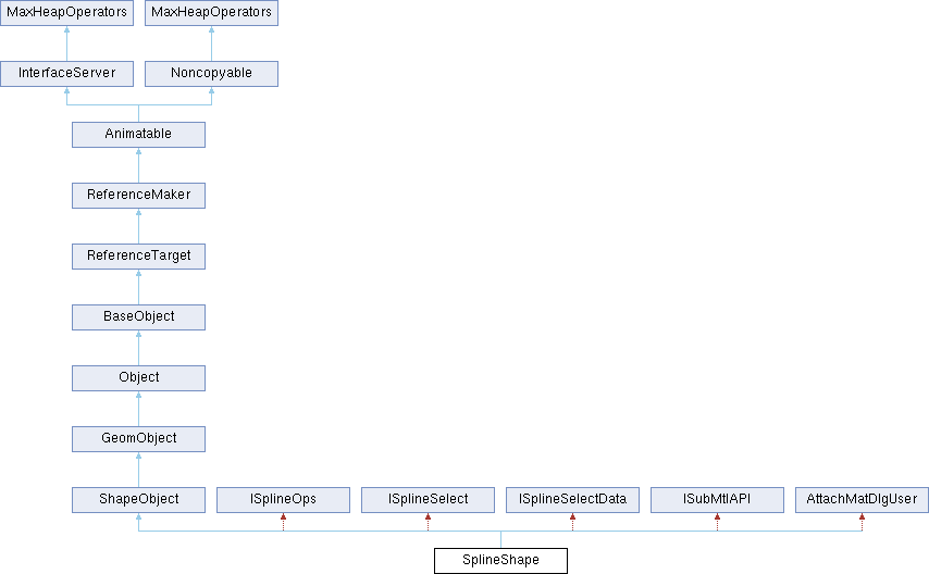

SplineShape Class Reference
#include <C:/adskgit/3dsmax/3dsmax/3dswin/src/maxsdk/include/splshape.h>
Inheritance diagram for SplineShape:
