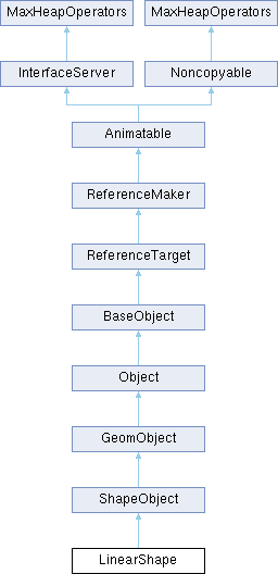

#include <C:/adskgit/3dsmax/3dsmax/3dswin/src/maxsdk/include/linshape.h>
Inheritance diagram for LinearShape:

Public Member Functions inherited from InterfaceServer
virtual UtilExport ~InterfaceServer ()
 Destructor.
template<class InterfaceType>
InterfaceType * GetTypedInterface ()

Protected Member Functions inherited from ShapeObject
virtual CoreExport bool IsRequiresLegacyDisplayMode () const
virtual CoreExport void SetReference (int i, RefTargetHandle rtarg) override
 This method sets the ShapeObject's parameter block pointer.
Protected Member Functions inherited from ReferenceTarget
CoreExport int DoEnumDependentsImpl (DependentEnumProc *dep) override
 Method to perform an enumeration on a ReferenceTarget.
virtual CoreExport ~ReferenceTarget ()=0
 Destructor.
Protected Member Functions inherited from ReferenceMaker
virtual CoreExport ~ReferenceMaker ()=0
 Destructor.
void BlockEval ()
 Validates a given reference link between this reference maker and its reference target.
void UnblockEval ()
int Evaluating ()
CoreExport RefResult StdNotifyRefChanged (const Interval &changeInt, RefTargetHandle hTarget, PartID partID, RefMessage message, BOOL propagate, NotifyDependentsOption notifyDependentsOption)
Protected Member Functions inherited from Animatable
virtual CoreExport ~Animatable ()=0
 Destructor.
Protected Member Functions inherited from Noncopyable
 Noncopyable ()
 ~Noncopyable ()
