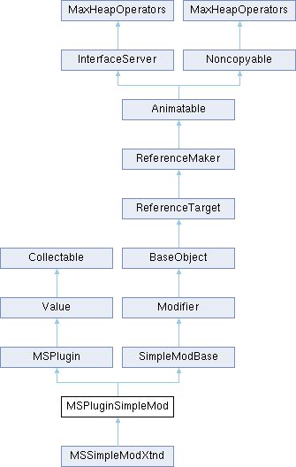

Inheritance diagram for MSPluginSimpleMod:
