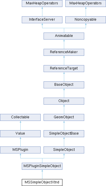

Inheritance diagram for MSSimpleObjectXtnd:
