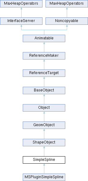

SimpleSpline Class Referenceabstract
#include <C:/adskgit/3dsmax/3dsmax/3dswin/src/maxsdk/include/simpspl.h>
Inheritance diagram for SimpleSpline:
