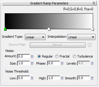

Interface
Gradient bar shows default gradient and interpolation types
[gradient bar]
Displays an editable representation of the gradient being created. The effect of the gradient moves from left (start point) to right (end point).
By default, three flags appear along the bottom edge of a red/green/blue gradient. Each flag controls a color (or map). The currently selected flag is green, and its RGB value and its position in the gradient (in the range 0 to 100) appear above the gradient bar. Each gradient can have any number of flags.

Gradient Type drop-down list
Chooses the type of gradient. The following Gradient types are available. These affect the entire gradient.
  • 4 Corner An asymmetrical linear transition of colors.
  • Box A box.
  • Diagonal A linear diagonal transition of colors.
  • Lighting Based on the light intensity value. No light=far left; brightest light=far right.
  • Linear A smooth, linear transition of colors.
  • Mapped Lets you assign a map to use as the gradient. Enables the Source Map controls for specifying the map and turning it on and off.
  • Normal Based on the angle between the vector from the camera to the object and the surface normal vector at the sample point. The leftmost flag of the gradient is 0 degrees; the rightmost flag is 90 degrees.
  • Pong A diagonal sweep that repeats in the middle.
  • Radial A radial transition of colors.
  • Spiral A smooth, circular transition of colors.
  • Sweep A linear sweep transition of colors.
  • Tartan A plaid.
Interpolation drop-down list
Chooses the type of interpolation. The following Interpolation types are available. These affect the entire gradient.

Source Map
Click to assign a map to a mapped gradient. The checkbox turns the map on or off.
The Source Map controls are available only when Mapped is the chosen gradient type.
Noise group
Amount
When nonzero, a random noise effect is applied to the gradient, based on the interaction of the gradient ramp colors (and maps, if present). The higher this value, the greater the effect. Range=0 to 1.
  • Regular Generates plain noise. Basically the same as fractal noise with levels disabled (because Regular is not a fractal function).
  • Fractal Generates noise using a fractal algorithm. The Levels option sets the number of iterations for the fractal noise.
  • Turbulence Generates fractal noise with an absolute value function applied to it to make fault lines. Note that the noise amount must be greater than 0 to see any effects of turbulence.
Size
Sets the scale of the noise function. Smaller values give smaller chunks of noise.
Phase
Controls the speed of the animation of the noise function. A 3D noise function is used for the noise; the first two parameters are U and V and the third is phase.
Levels
Sets the number of fractal iterations or turbulence (as a continuous function).
Noise Threshold group
When the noise value is above the Low threshold and below the High threshold, the dynamic range is stretched to fill 0 to 1. This causes a smaller discontinuity at the threshold transition and produces less potential aliasing.
High
Sets the high threshold.
Low
Sets the low threshold.
Smooth
Helps make a smoother transition from the threshold value to the noise value. When Smooth is 0, no smoothing is applied. When Smooth is 1, the maximum amount of smoothing is applied.
