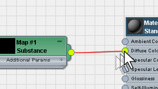

- From the Maps list in the Material/Map Browser, drag the Substance map to the Diffuse (or other) input socket on the Standard material.

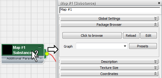

- Double-click the Substance map node in the View.
Its parameters appear in the Parameter Editor on the right side of the Material Editor.
- On the first rollout, Package Browser, click the “Click to browse” button.

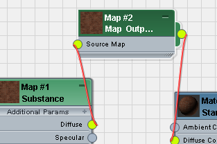

After you open the Substance file, 3ds Max automatically inserts a Map Output Selector map node between the Substance node and the material node. This node is necessary for most Substances, which produce several different output types (or channels) simultaneously. (Some Substances produce only one output type; these don’t need the Map Output Selector.) You can use the Map Output Selector to change the type of output of the Substance map that is connected to the material input socket without having to rewire the two nodes.

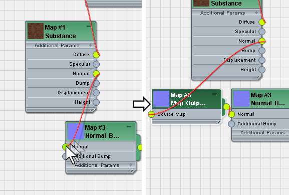

Because the Substance map produces different types of output, you can apply the same map to different material inputs, as in the following example, which shows how to use the Substance’s Normal output as a bump map.
- From the Maps list in the Material/Map Browser, drag the Normal Bump map to the Bump input socket on the material.
- Drag between the Normal input socket on the Normal Bump map node and the Normal output socket on the Substance map.
Again, after performing the wiring, 3ds Max automatically inserts a Map Output Selector node between the two nodes.
If you double-click each Map Output Selector node in turn, you can see that the first is set to the Diffuse channel while the second is set to the Normal channel.
