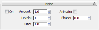

These controls appear on the Noise rollout for many 2D maps:
- On
Determines whether the Noise parameters affect the map.
- Amount
Sets the strength of the fractal function, expressed as a percentage. If the amount is 0 there is no noise. If the amount is 100 the map becomes pure noise. Default=1.0.
- Levels
Or iterations: The number of times the function is applied. The effect of the level is dependent on the Amount value. The stronger the amount, the greater the effect of increasing the Levels value. Range=1 to 10; Default=1.
- Size
Sets the scale of the noise function relative to geometry. At very small values, the noise effect becomes white noise. At large values, the scale can exceed the scale of the geometry, in which case it has little or no effect. Range=0.001 to 100; Default=1.0.
- Animate
Determines whether animation is on the noise effect. This parameter must be turned on if you intend to animate the noise.
- Phase
Controls the speed of the animation of the noise function.
