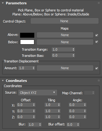

Parameters
- Control Object
- Selects a control object from the scene. Can be a plane, box or sphere.
- Above/Inside
- Selects the color of the material to be placed above the surface of the plane or inside the box or sphere. Alternatively, enable the check box to use a selected map.
- Below/Outside
- Selects the color of the material to be placed below the surface of the plane or outside the box or sphere. Alternatively, enable the check box to use a selected map.
- Transition Range
- Sets a transition for blending the colors or maps.
- Transition Bias
- Expands or contracts the masked area.
- Transition Displacement
- Displaces the masked area with a selected map.
