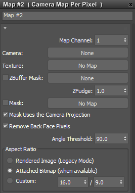

Interface
Map Channel
Sets which map channel to use. Default=1.
Camera
Click to turn on, and then choose a camera in the scene by selecting it in a viewport, or press H to use the Pick Object dialog.
Once you have assigned a camera, its name appears on this button.
This camera should be the one used to render the map used in the Texture and ZBuffer Mask components.
Texture
Click to assign the texture to project. You can assign any kind of map, but typically this is a Bitmap that contains an image file that you first rendered from the same camera, and then possibly edited with a different application.
ZBuffer Mask
Click to assign a map that contains Z-depth data used to mask the projection from unwanted surfaces. Typically this is an RPF file or an RLA file rendered using the same camera, with the Z channel option turned on.
Use the toggle to turn use of the ZBuffer Mask on or off. By default, it is off, and it is not turned on automatically when you assign the ZBuffer Mask.
  • ZFudge ZFudge values other than 1.0 add a margin of deviation to the use of the Z-depth data, letting you fine-tune the Z-Buffer masking. Default=1.0.
Mask
Behaves like the mask in the Mask map by letting you view one map through another. Black areas of the mask are transparent, white areas are opaque, and gray areas are partially transparent, based on the percentage of the gray.
  • Mask Uses the Camera Projection When on, the mask uses the same camera projection as the Texture and ZBuffer Mask. When off, it uses the object's UVW coordinates. Default=on.
Remove Back Face Pixels
When on, sets the projection to exclude surfaces that face away from the camera, based on the value of Angle Threshold. Default=on.
  • Angle Threshold Specifies the angle to use as a cutoff when removing backface pixels. Default=90.0.
    At the default of 90 degrees, faces perpendicular to the camera, or at a greater angle, are not projected.
Aspect Ratio group
Rendered Image (Legacy Mode)
Sets the aspect ratio according to the image currently being rendered.
Note: With this mode, the projection may change if the output resolution is adjusted.
Attached Bitmap (when available)
Sets the aspect ratio from the attached bitmap if one has been selected.
Note: If any other type of texture is used from which an aspect ratio cannot be deduced, the Custom aspect ratio will be used instead.
Custom
Sets a custom width-to-height aspect ratio for the projection.
