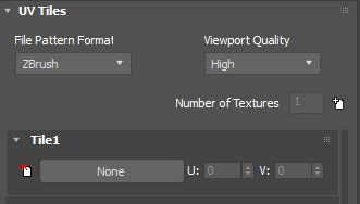

UV Tiles rollout
File Pattern Format
Selects a file pattern format: Zbrush, Mudbox, UDIM (Mari) or Custom.
Use Custom when selecting image file types such as jpegs and bitmaps.
Viewport Quality
Selects the viewport display quality.
Number of Textures
Shows the current number of texture tiles.
Add Tile button
Click to add tiles.
Delete Tile button
Click to delete a tile.
Tile button
Click the Tile button to select a file to as a new tile. The button shows the name of the currently-selected file or None if no file has been selected.
U V
Enter values to position the tile in the UV editor, with the values corresponding to UV space. For example, enter 0,0, or 1,0, or any other desired value such as 4,4 etc..
