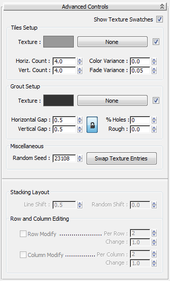

Advanced Controls rollout
Show Texture Swatches
When on, the Texture swatch for Tiles or Grout updates to show the map you assign. Default=on.
Tiles Setup group
Texture
Controls the display of the current texture map for the tiles. When on, the texture is used as the tile pattern instead of the color swatch. When turned off, the color of the tiles is displayed; clicking the color swatch displays the Color Selector.
[Texture button]
Acts as a target where you drag and drop maps for the tiles. When you click this button with a map assigned, 3ds Max displays the rollout for the map. Before a map is assigned, the label reads "None."
The checkbox controls whether the map is used or not.
Horiz. Count
Controls the number of tiles in a row.
Vert. Count
Controls the number of tiles in a column.
Color Variance
The greater this value, the greater the color varies among individual tiles. Range: 0.0 to 100.0. Default = 0.0.
Left: Color Variance = 0.0
Right: Color Variance = 1.0
Fade Variance
The greater this value, the greater the color of individual tiles is "faded" or desaturated. Range: 0.0 to 100.0. Default = 0.05.
Left: Fade Variance = 0.05
Right: Fade Variance = 1.0
Grout Setup group
Texture
Controls the display of the current texture map for the grout. When on, the texture is used as the grout pattern instead of the color swatch. When off, the color of the grout is displayed, and clicking the color swatch displays the Color Selector.
[Texture button]
Acts as a target where you drag and drop maps for the grout. When you click this button with a map assigned, 3ds Max displays the rollout for the map. Before a map is assigned, the label reads "None."
Horizontal Gap
Controls the horizontal size of the grout between the tiles. This value is locked by default to the vertical gap, so that both values change as you edit one or the other. To unlock them, click the lock icon.
Vertical Gap
Controls the vertical size of the grout between the tiles. This value is locked by default to the horizontal gap, so that both values change as you edit one or the other. To unlock them, click the lock icon.
% Holes
Sets the percentage of holes in the tiled surface caused by missing tiles. The grout shows through the holes.
Rough
Controls the roughness of the edges of the grout.
Miscellaneous group
Random Seed
Randomly applies patterns of color variation to the tiles. Does not require any other setting to generate completely different patterns.
Swap Texture Entries
Swaps the texture maps or colors between the tiles and the grout.
Stacking Layout group
Note: This group of controls is active only when Custom Tiles is selected in Standard Controls rollout Pattern Setup Preset Type.
Line Shift
Shifts every second row of tiles a distance of one unit.
Random Shift
Randomly shifts all rows of tiles a distance of one unit.
Row and Column Editing group
Note: This group of controls is enabled only when Custom Tiles is selected in Standard Controls rollout Pattern Setup Preset Type.
Row Modify
When on, creates a custom pattern for rows, based on the values of Per Row and Change. Default=off.
  • Per Row Specifies which rows to change. When Per Row equals 0, no rows change. When Per Row equals 1, every row changes. When Per Row is a value greater than 1, the change appears every N rows: A value of 2 changes every second row, a value of three changes every third row, and so on. Default=2.
  • Change Changes the width of tiles in the affected rows. A value of 1.0 is the default tile width. Values greater than 1.0 increase the width of tiles, and values less than 1.0 decrease it. Range=0.0 to 5.0. Default=1.0.
    A value of 0.0 is a special case: When the Change value is 0.0, no tiles appears in that row, and the underlying material shows through.
Column Modify
When on, creates a custom pattern for columns, based on the values of Per Column and Change. Default=off.
  • Per Column Specifies which columns to change. When Per Column equals 0, no columns change. When Per Column equals 1, every column changes. When Per Column is a value greater than 1, the change appears every N columns: A value of 2 changes every second column, a value of three changes every third column and so on. Default=2.
  • Change Changes the height of tiles in the affected columns. A value of 1.0 is the default tile height. Values greater than 1.0 increase the height of tiles, and values less than 1.0 decrease it. Range=0.0 to 5.0. Default=1.0.
    A value of 0.0 is a special case: When the Change value is 0.0, no tile appears in that column, and the underlying material shows through.
