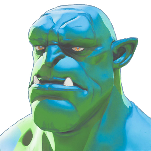

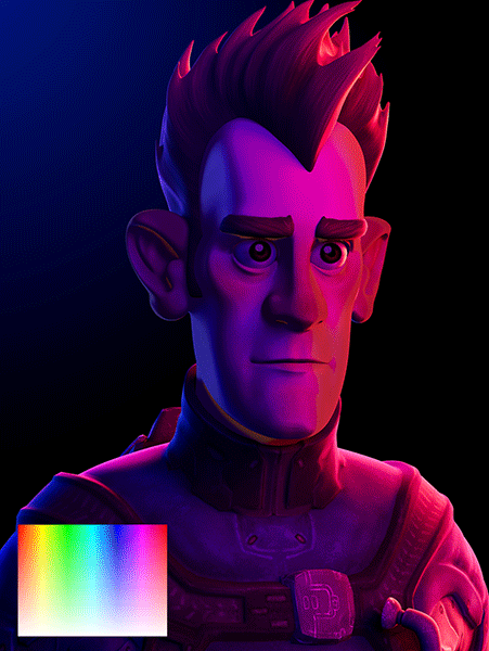

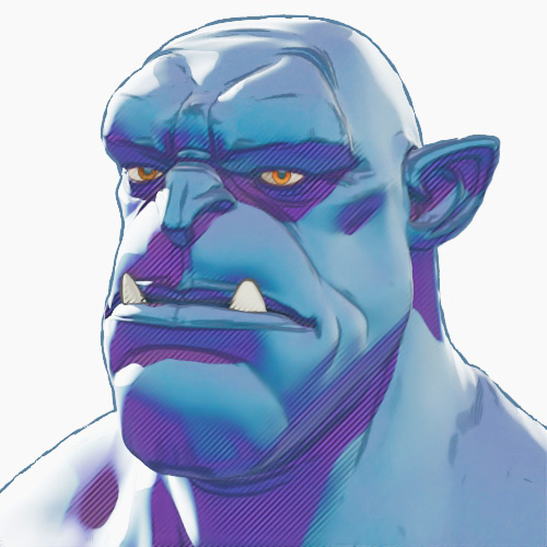

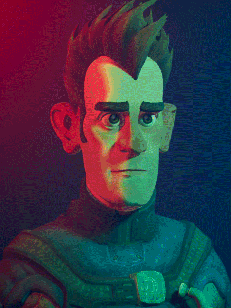

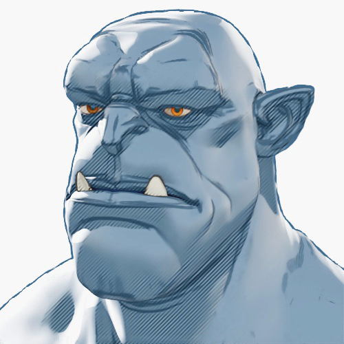

- Toon tone-mapping: You can now drive the hue and saturation of tonemapping in the toon shader. The toon shader has four new parameters that complement the existing value-based tonemapping parameters. The connected shader's U coordinate drives direct light hue and the V coordinate drives saturation, which enables textures like those below to map the toon shader's response to colored lighting (Note: make sure to set the image's wrapping mode to
clampand filter toclosestfor best results) (ARNOLD-10687). These toon parameters include:- edge_tonemap_hue_saturation
- silhouette_tonemap_hue_saturation
- base_tonemap_hue_saturation
- specular_tonemap_hue_saturation
No base_tonemap_hue_saturation image -> base_tonemap_hue_saturation image -> specular_tonemap_hue_saturation

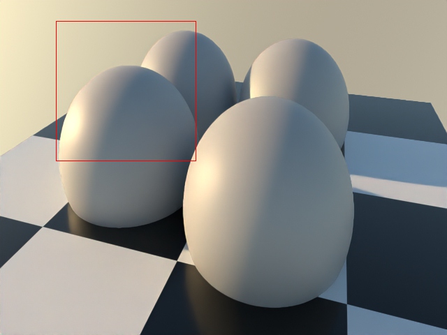

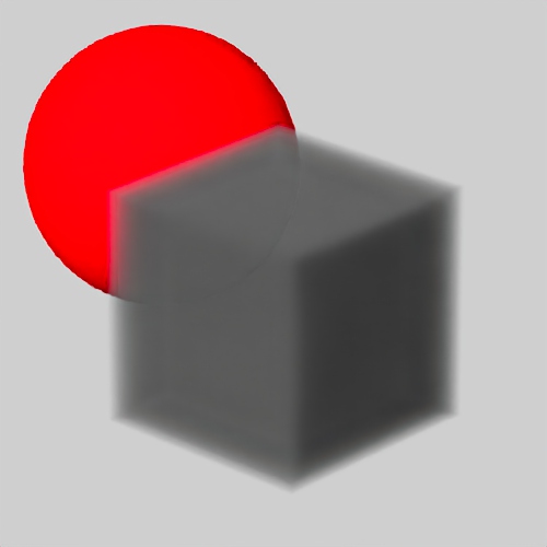

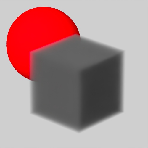

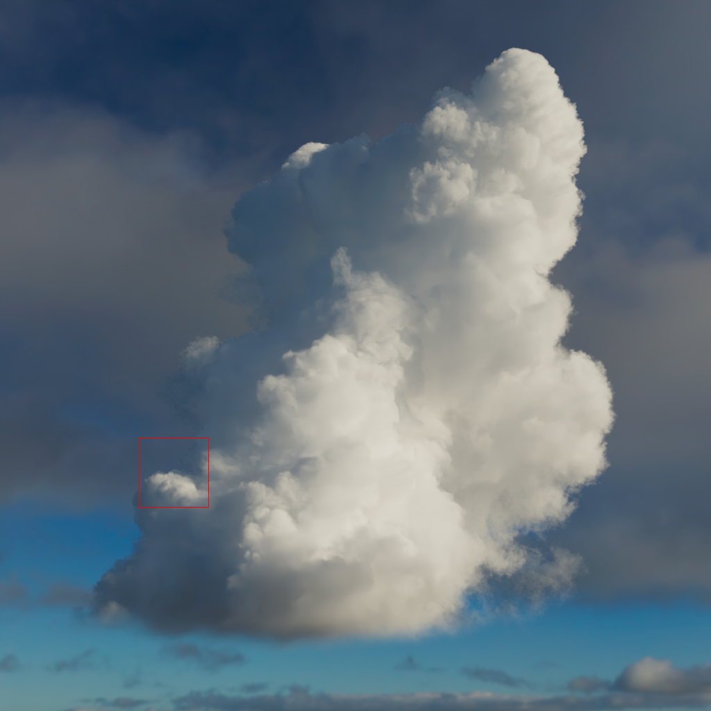

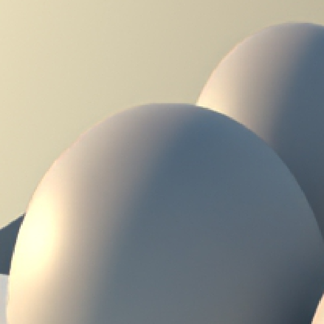

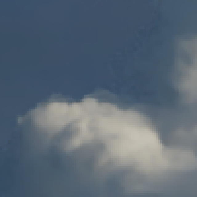

Color palette images -> base_tonemap_hue_saturation image.offset_u: 0 to 1 (light color is unchanged) - Better volume denoising: Denoising volumes now produces better results. The changes in how volume albedo is computed help the denoiser to keep more details. Ringing artifacts when objects are viewed against the background are also reduced, and a new
N_denoiseAOV fixes some denoising artifacts visible in low-AA renders. (ARNOLD-14936, ARNOLD-13071)
7.3.1 7.3.2
7.3.1 7.3.2
7.3.1 7.3.2

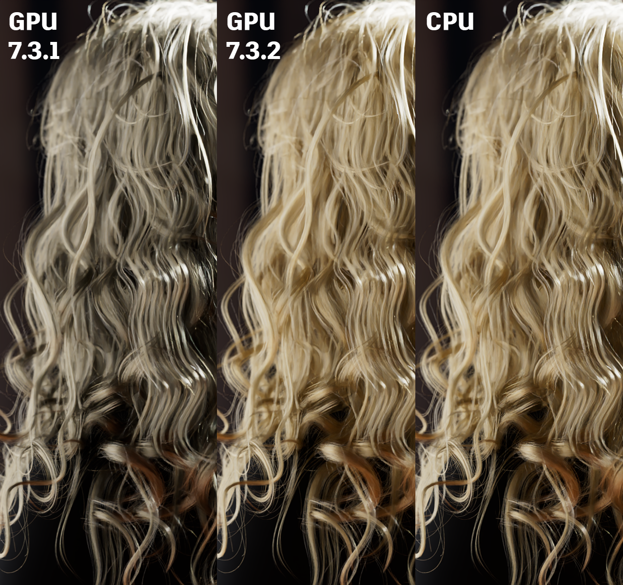

- Improved Standard Hair on GPU: The GPU renderer now supports the extra_depth parameter. This enables accurate rendering of blond or bright-colored hair without raising GI_specular_depth.
